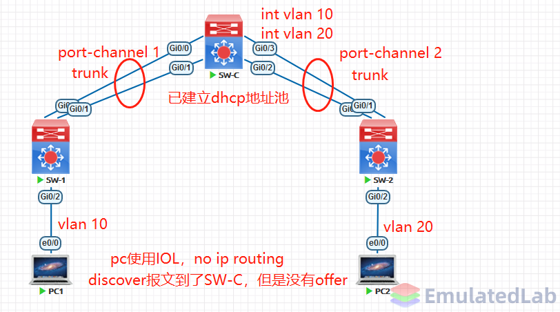

如下图,SW-C作为DHCP服务器,能够收到Discover报文,但是没有响应offer
配置如下:
SW-C:
ip dhcp pool vlan10
network 192.168.1.0 255.255.255.0
default-router 192.168.1.1
dns-server 10.10.10.10
ip dhcp pool vlan20
network 192.168.2.0 255.255.255.0
default-router 192.168.2.1
dns-server 20.20.20.20
interface Vlan10
ip address 192.168.1.1 255.255.255.0
interface Vlan20
ip address 192.168.2.1 255.255.255.0

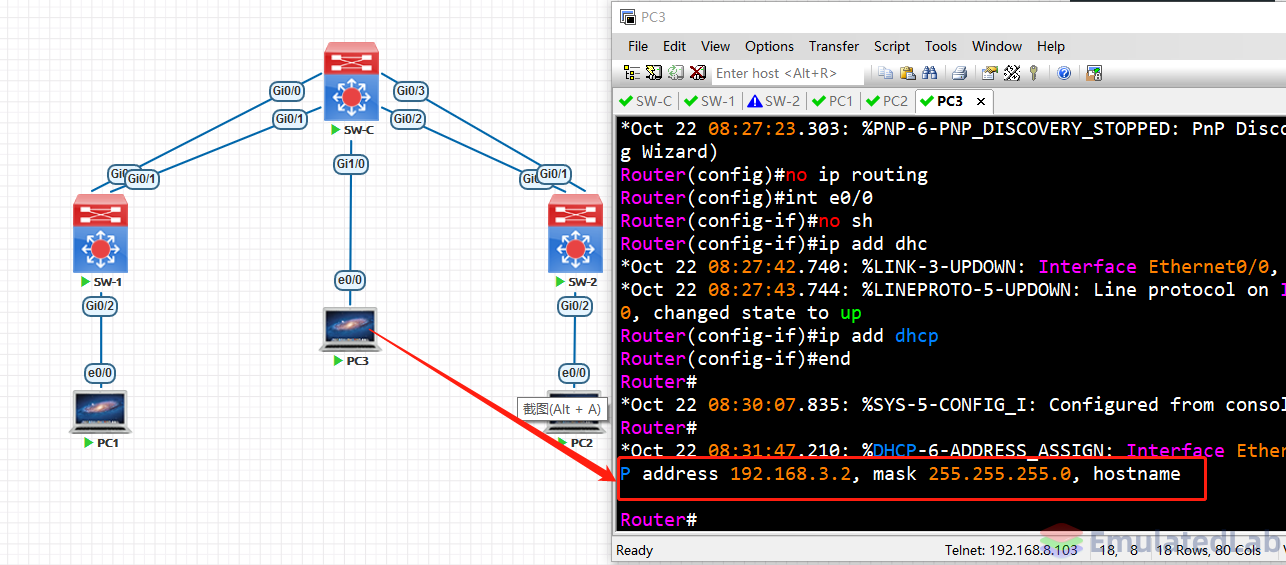

然而,直连的PC3,在相同的配置下,能够获得IP地址
