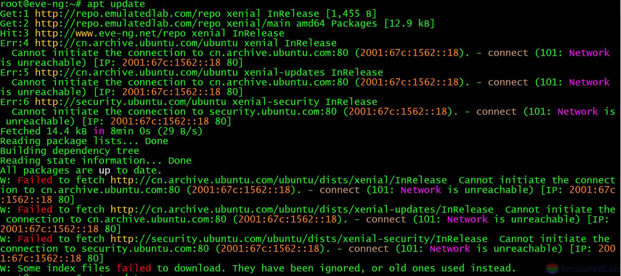

禁用IPV6
  1. sysctl -w net.ipv6.conf.all.disable_ipv6=1
