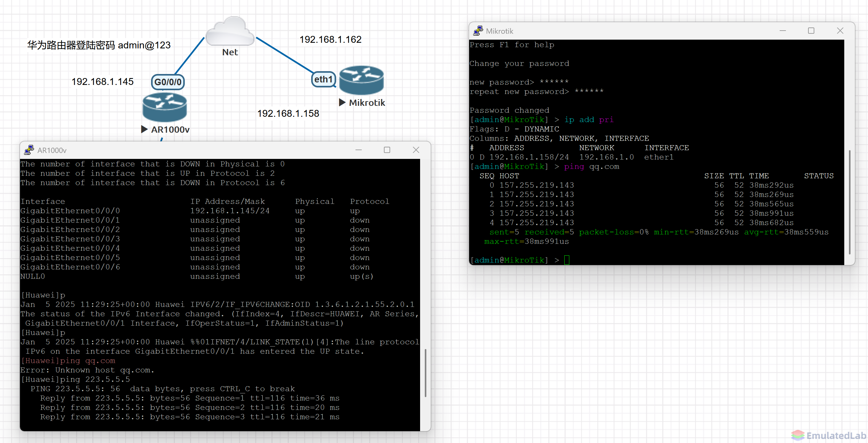

同一朵云,为何dhcp方式,华为AR1220,可以ping通223.5.5.5,但是却ping不通qq.com;mikrotik 完全正常。
华为连接云朵的接口 配置:
[Huawei-GigabitEthernet0/0/0]dis th
[V300R021C00SPC100T]
interface GigabitEthernet0/0/0
ipv6 enable
ipv6 address auto link-local
ipv6 address auto global default
ip address dhcp-alloc
ipv6 address auto dhcp

因为你没开DNS解析
dns resolve
dns server x.x.x.x(DNS地址)
